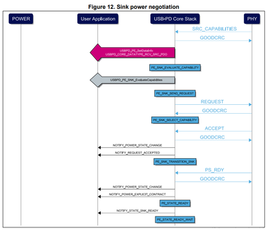

Here is what I have found so far, using this flow diagram as the expected sequence of events in a Sink Power negotiation:
-Device gets through initialization and reads the VBUS voltage correctly.
-When a USB-C cable is plugged in (USB-C to USB-C cable with USBPD capable power source) the program is able to enter the USBPD_DPM_SetDataInfo, but instead of entering with a USBPD_CORE_DataInfoType_TypeDef of USBPD_CORE_DATATYPE_RCV_SRC_PDO, it enters with USBPD_CORE_DATATYPE_RDO_POSITION and then with a subsequent call with USBPD_CORE_DATATYPE_RCV_REQ_PDO. It then repeats this a second time with nothing happening. This doesn't match the flow in the picture above.
-USBPD_DPM_SNK_EvaluateCapabilities is never called.

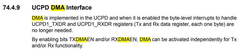

The GPDMA IRQ handlers are empty, and this is intentional, since the DMA transfer is being handled by HW in pooling mode.
When debugging, you can check transfer complete flags in GPDMA_C3CR are all set to zero which means they are not in interrupt mode.

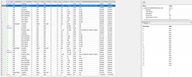

2025-01-29 6:47 AM
Okay thanks for trying that.
I have attached my trace file (although it may not be what you are requesting, I generated this .txt file from the STM32CubeMonitor UCPD). If it isn't what you are looking for, let me know.
I likely won't be able to give you the whole project but I may be able to give you particular files or screenshots of some of the code. Are there any particular files that would be useful for you?
Thanks.

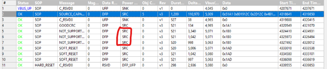

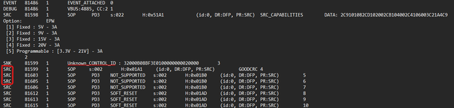

2025-01-29 7:09 AM
2025-01-30 2:48 AM
Hi @cd3361
The source sends its capabilities. However, your sink device sends NOT_SUPPORTED messages and initiates SOFT_RESET. Check your sink PDOs list. The sink device is not properly handling the received SRC_CAP.
2025-01-30 6:12 AM
Just double checking, is the NOT_SUPPORTED from the Sink or the Source? It looks to me like it is coming from the Source:
