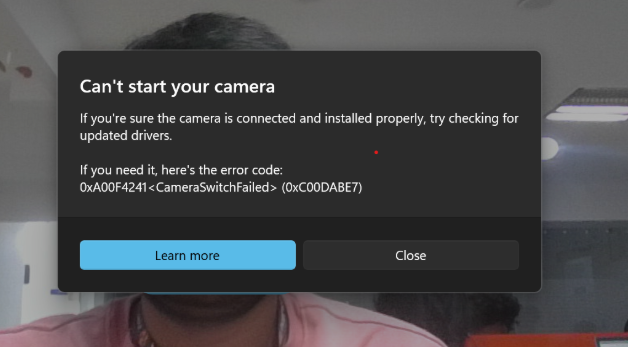

I am working with the STM32N6570-DK and the USBX Ux_Device_Video example from
STM32Cube_FW_N6_V1.3.0\Projects\STM32N6570-DK\Applications\USBX\Ux_Device_Video.
I followed the README instructions exactly:
Built FSBL and Ux_Device_Video projects successfully in STM32CubeIDE
Generated FSBL.bin and Ux_Device_Video.bin
Signed both binaries using STM32_SigningTool_CLI
Programmed:
FSBL-trusted.bin at 0x70000000 (external flash)
Ux_Device_Video-trusted.bin at 0x70100000 (external flash)
Set BOOT0 and BOOT1 to boot from external flash and reset the board
However, the application does not run as expected. When the board is connected to a Windows PC, the Windows Camera application fails with the error:
Can't start your camera
0xA00F4241 <CameraSwitchFailed> (0xC00DABE7)
From my understanding, the Ux_Device_Video example should enumerate as a USB UVC camera and stream video to the Windows Camera app. Since the camera app fails, it seems the firmware may not be executing correctly on the STM32 side (FSBL → application handoff).

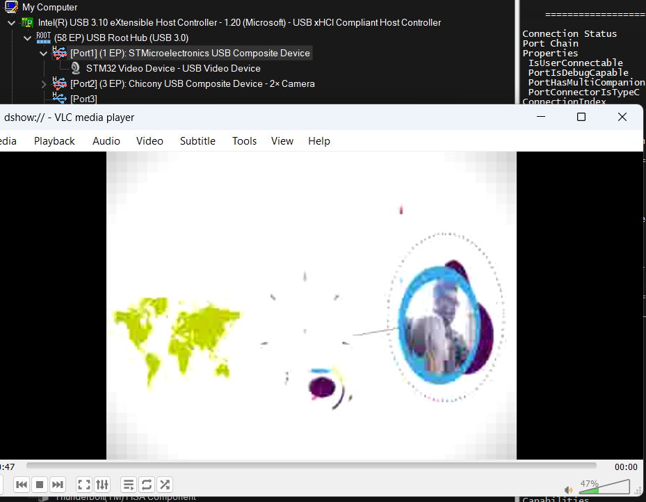

2026-01-23 1:16 AM
Hi @Grace_04
First, thank you for your feedback.
This might be an issue linked to Windows Camera not firmware/UVC issue. Would you test with another UVC tool? for instance VLC? or any other tools? Make sure to get it enumerated first in device manager.

2026-01-28 2:11 AM
Hi @Grace_04
Thanks for confirming your setup.
You may need to provide board revision. It's marked on the board MB1939-N6570-C02 on my end.
Each time you change boot settings, please perform a power-on reset on the board (fully power cycle the board, not just NRST).
Connect the board’s USB device port directly to the PC with a known-good USB cable (avoid hubs for debugging). If still not working, select the Ux_Device_Video workspace and run in mode debug so we can identify where it get's stuck.
On my end, it is working as expected.
