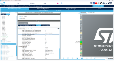

Hi @treepreeyuh
Have you tried to generate code using CubeMX?
