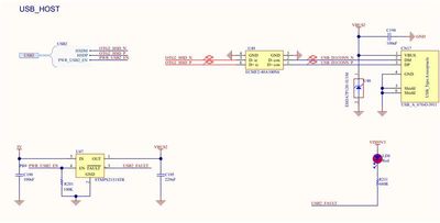

I assume in case, you don't use UCPD peripheral, you need to make some hardware change in schematics to pull down CC lines with 5.1KOhms and reconfigure TCPP port to type C only. Otherwise, use the second USB controller as implemented type C only.
