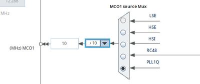

I'm here on H753, external clock, CPU clock configured to 400MHz. Setup code is generated by CubeMx.
If I execute a HAL_Delay() takes twice the time as expected, e.g. 2ms instead 1ms. I checked via GPIO toggle with a scope.
The MCO output is correct, so I guess the CPU clock is correct.
The system core clock variable is calculated/set to 400MHz after system clock initialization.
I remember I watched the same problem on another M7 chip, the SAME70.
I fixed it by patching the SYSTICK setup (HAL_SYSTICK_Config) but I'd like to know what is the problem here.
It seems to me, the SYSTICK is fed by 200MHz, not 400MHz as suggested in the CubeMx clock tree.
Does anybody have experienced this or can share information regarding SYSTICK?
Thanks,
Jochen

you set the HSE to the real value, thats on your board ?
ok ?
then read about delay...+/-1 tick:
http://www.efton.sk/STM32/gotcha/g13.html
Delay wrong? ...so do some test:
1. make 100ms hal delay, writing hi/lo to a pin, and check with scope : is 100ms +/- 1 ?
2. if wrong, use and set MCO , to some part of core clock
..and check with scope. Then you know, what clock speed inside running.

2025-07-06 7:15 AM
I would have expected a jitter between 1 and 2ms, not always exactly 2m delay. But your hint regarding the resolution problem / minimum delay sound plausible. I'll do the 100ms test tomorrow and get back here. Thanks.
