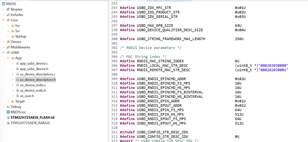

The generated code on file ux_device_descriptor.h  at line 308 is:
#define USBD_RNDIS_EPINCMD_ADDR 0x81U
In the exemple code of STM32H735-DK find on stm32-usbx-exemple repo I have this
#define USBD_RNDIS_EPINCMD_ADDR 0x82U
The USB device is well recognized be my computer (windows 11) only if the value is 0x82U.

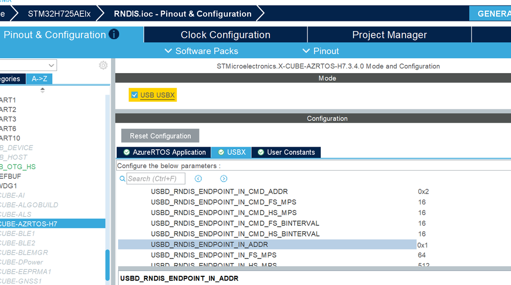

Hi @Dams
With the configuration below, the code is generated correctly. In particular, the IN endpoint address and the IN endpoint command address are assigned the additional values 0x81 and 0x82, respectively, since bit 7 indicates the direction (0 for OUT, 1 for IN).

Hi @Dams
I hope it's clear.

Dams
Associate III
Hi @FBL ,
Thanks for the solution:
Have a nice day.
