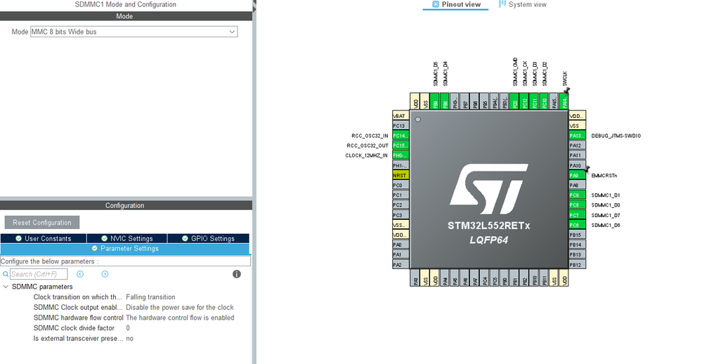

Hello @ChahinezC ,
Thanks for reaching out!
I've built a specific project for the purpose of demonstrating this issue. I'll attach the .ioc and main.c files (the only ones that have been modified) and write the main code here as well for anyone interested.
If the information is helpful, I'm currently connected to a Kingston e*MMC 5.1 EMMC64G-IB29-90F02 .
I'll add the additional files in the following comments, because this only seems to allow me to attach one file at a time.
