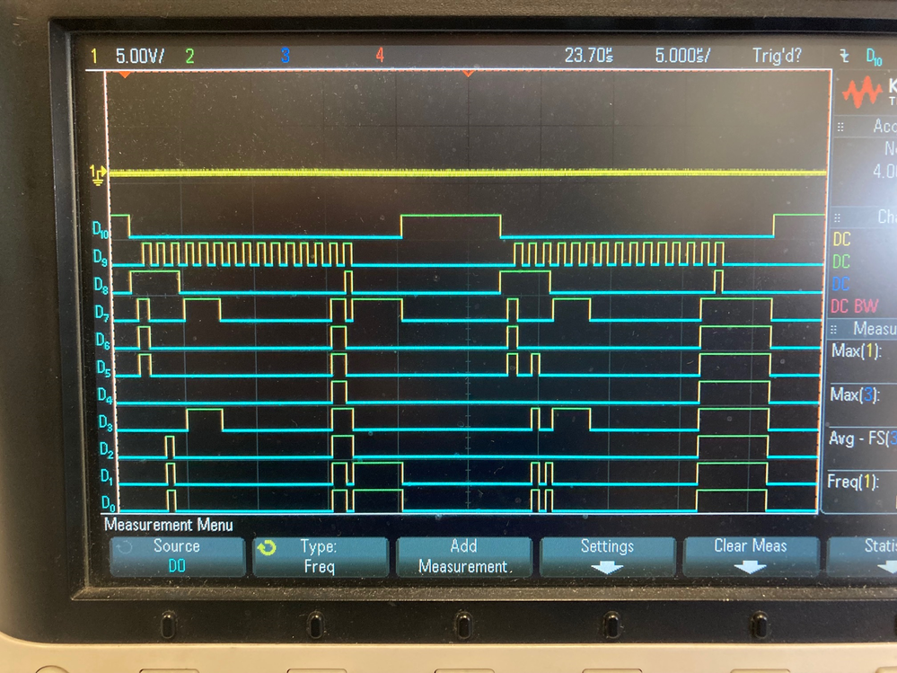

We are using a STM32L4Q5AGIx device with Hyperbus PSRAM IS66WVH8M8BLL chip on a custom board. We are having a number of issues getting the RAM to work corectly on Port 2 and right now are isolating it to reading any of the 4 internal registers, ID0, ID1, CR0, CR1. Assuming we can successfully read those registers, we will know our system is configured correctly and communicating properly. Our main clock is 120 MHz. We have setup to run the OSPI at 1MHz to aid debugging.
Here is what we observe when we attempt to read ID0;

Here is a logic analyser picture. D0-D7 correspond to the data lines, D8 is DQS, D9 is CLK, and D10 is CS.
So from all this I'd love some insight into what is going on here.
Thanks for any help.
2024-02-23 12:25 AM
Hello @BComp ,
Could you please check the OCTOSPI configuration like as Chip select boundary (CSBOUND) and Refresh rate These settings depend on the memory datasheet.
- The chip select must go high when crossing the page boundary (2^CSBOUND bytes defines the page size).
- The chip select must go high each (REFRECH x OCTOSPI clock cycles).
For the CSBOUND boundary configuration please refer to the errata sheet section 2.6 OCTOSPI.
May be this example can help you.
Thank you.
