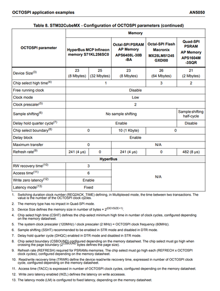

Is the delay block enabled or disabled?
Could you please refer to AN5050 table 8. and check your OCTOSPI configuration.
Please take a look at Help needed for tuning 64Mb HYPERRAM (S27KL0642DPBHI020) on STM32H735IGT6 discussion may help you.
Thank you.

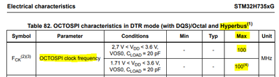

Also could you please try to decrease the OCTOSPI frequency:
Thank you.
