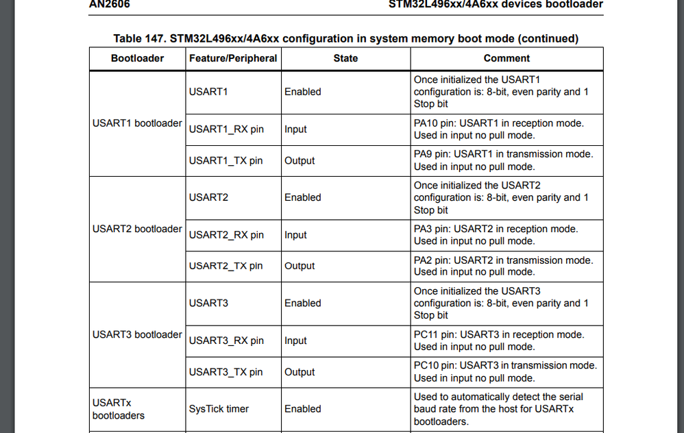

Bootloader only responding on PC10 and PC11, but not on PA2,PA3,
how to select a particular UART port for bootloader?
2023-05-31 7:46 AM
It is typically looking for signal transitions on multiple pins, first one to see traffic wins the race.
Make sure the other RX pins are not noisy, ie data from a GPS/GNSS receiver that squawks at startup.
