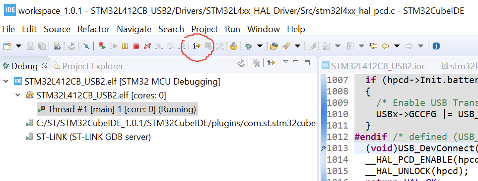

2019-07-20 3:03 PM
(picture courtesy of @SToma )

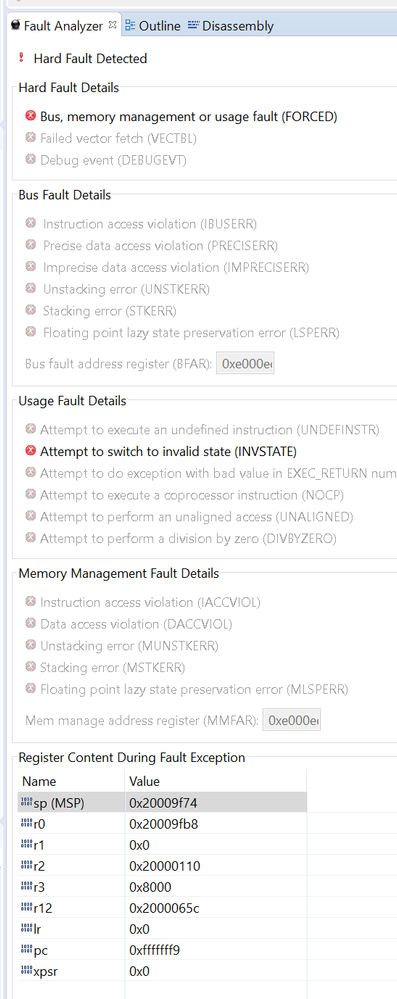

what I found in Truestudio was the problem window.
It reports an hard fault and gives some info, unfortunately I do not understand what it means.

My guess is, that the problem occurs in the USB interrupt service routine (ISR), and you have disabled interrupts during single-step (that's a common setting, otherwise it would be hard to single-step most practical programs).
You may perhaps want to place a breakpoint into the USB ISR and single-step from there to see, where that will take you.
Do you have a PC connected to the USB when the problem occurs?
