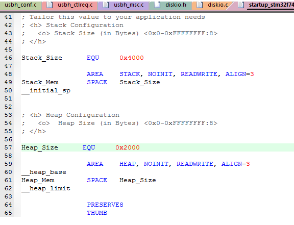

Stack Allocation in startup_stm32746xx.s as below:

You have posted a top level abstraction ST uses, you want to be testing\evaluating the "usb_diskio_whatever.c" files, and ensuring that you can in fact reliably read and write blocks from the block storage device. It must be able to recover the same data written to the block previously, and not corrupt other/surrounding blocks.
You need to understand the nature of the failure that FatFs subsequently FR_DISK_ERR (or whatever) in order to be able to remediate the problem.
Stack/Heap look plenty large. On the F7 I'd recommend using the DTCMRAM when using DMA, otherwise you'll need to manage the cache-coherency more explicitly
