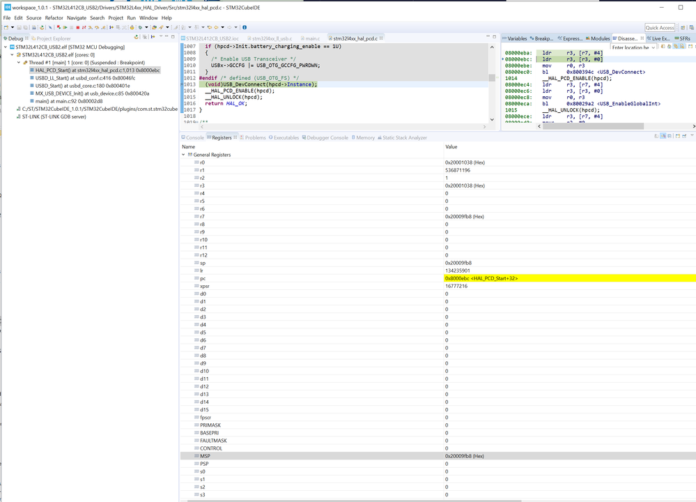

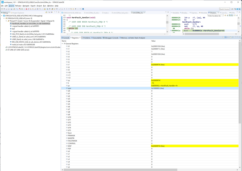

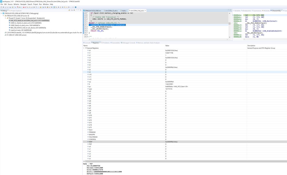

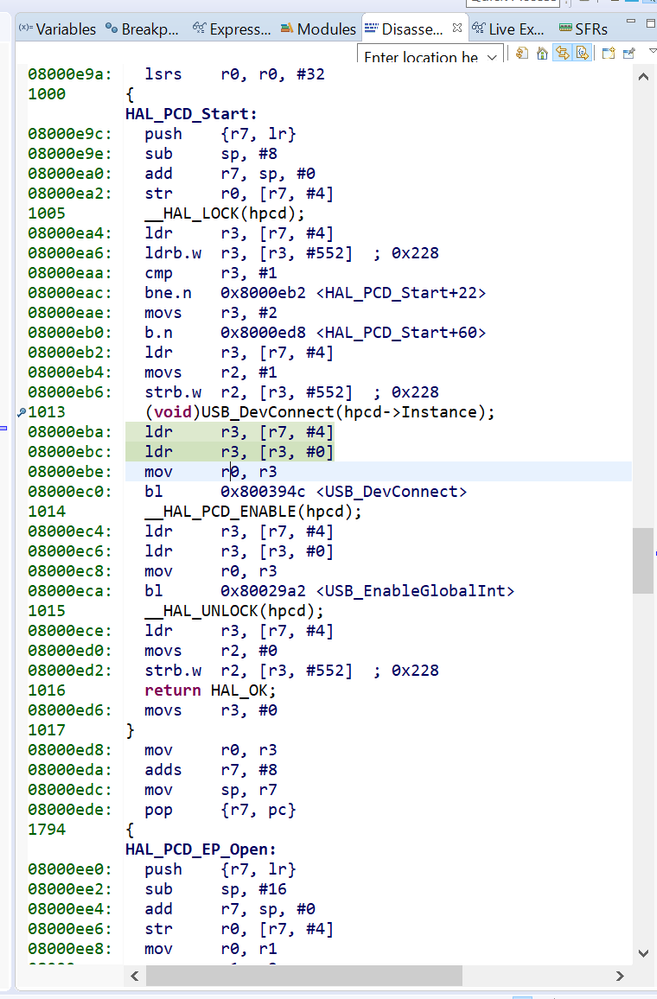

2019-07-20 12:48 PM
Hi.
I do not have any way to print the printf output right now.
So I checked with TrueStudio (Stm32CubeIDE)
I have tested this with both Truestudio 9.3 and Stm32CubeIDE with the same result.
I set the breakpoint at the position before the error accrue, and each picture is an step in assembly.
next
next
next
next
Hard fault
and assembly code at the error
I do not know ow to follow this, becuas from my perspective it looks well and fine before the error hits.
Hope there is a way to solve this.
btw, Thanks Clive for all your help, indirect (others post) and direct :)

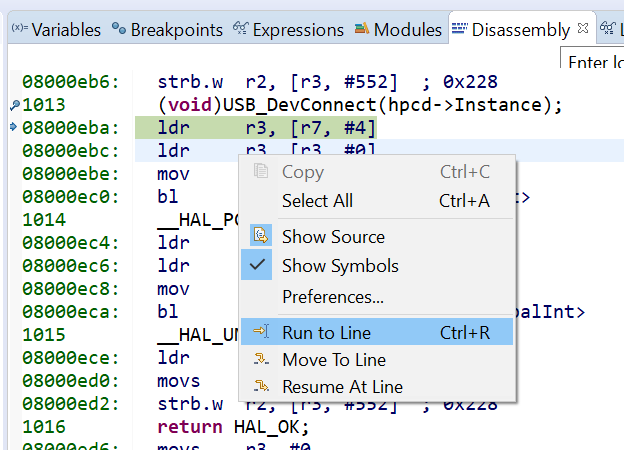

2019-07-20 12:59 PM
I'd say, you used "step over" rather than "step into" (I don't use eclipsoids so I don't know exactly which key does what). In other words, IMO you run the USB_DevConnect routine, and failed somewhere there.
Learn how to "step into" and step until the fault occurs.
2019-07-20 1:53 PM
Hi JW.
I am not a eclips guy my self, so I am no expert.
But I used "run to line" for each "step"
I culd not find another way to do it (Assembly step).
