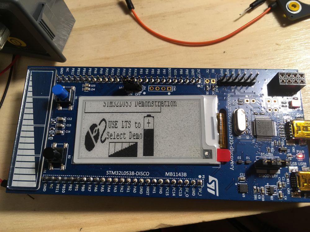

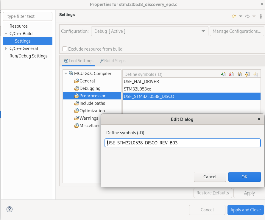

2023-01-06 3:15 AM
I finally got the demo program running on a RevB03 board. :rocket:
Sharing this for my future self or for others in the same situation:
5. Build and flash
The dimensions of this display must be different from the original, because the GUI looks truncated but otherwise it works as documented in the readme.txt
