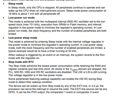

Additionally, I was thinking that instead of running the CPU in normal mode during the awake time, perhaps I can run it in some other mode?
Can I use Sleep mode (not standby) or low-power run mode and still use SPI/I2C interfaces?
I am happy with the standby current consumption but I would like to reduce the awake current consumption (5mA)

Even if that's possible (I don't know), it's a trade between "some-slow-mode-that-takes-longer" vs. a short regular CPU use.
So just try...
