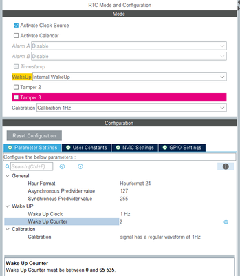

1) Set CubeMX: activate RTC clock source, enable internal wake up, set wake up clock to 1 Hz clock, set wake up timer to 2 (just a random value, don't care), output 1 Hz signal to verify on oscilloscope the RTC is running (and I can confirm I see 1 Hz waveform on my scope at the corresponding pin)
