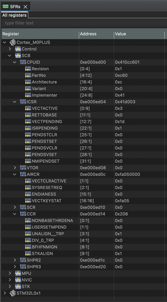

2025-08-19 1:05 PM
Because it's a Cortex M0 i don't have a lot of Hard Fault information (or do i?). I get the following from the debug window.

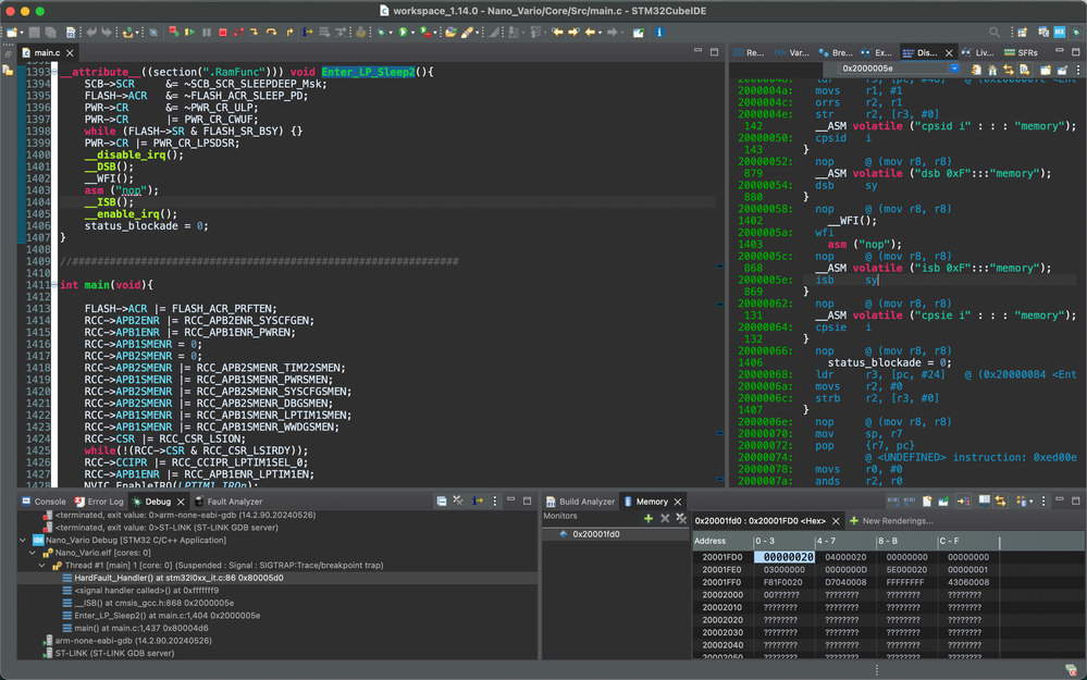

2025-08-19 10:08 PM - edited 2025-08-19 10:25 PM
Just „Hard Fault Detected“, nothing else. And the Adress 0x20001fd0 at the bottom right is the one from the MSP. So the Stack Frame is:
2025-08-19 10:25 PM
Then do it "manually", by opening the SCB peripheral in the debugger, and note the fault register values.
Worst case (your debugger has no such feature) look up the register addresses in the reference manual, and check the respective memory locations.
2025-08-19 10:33 PM - edited 2025-08-19 10:54 PM
Are there any for the Cortex M0? I read there aren‘t.
