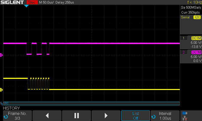

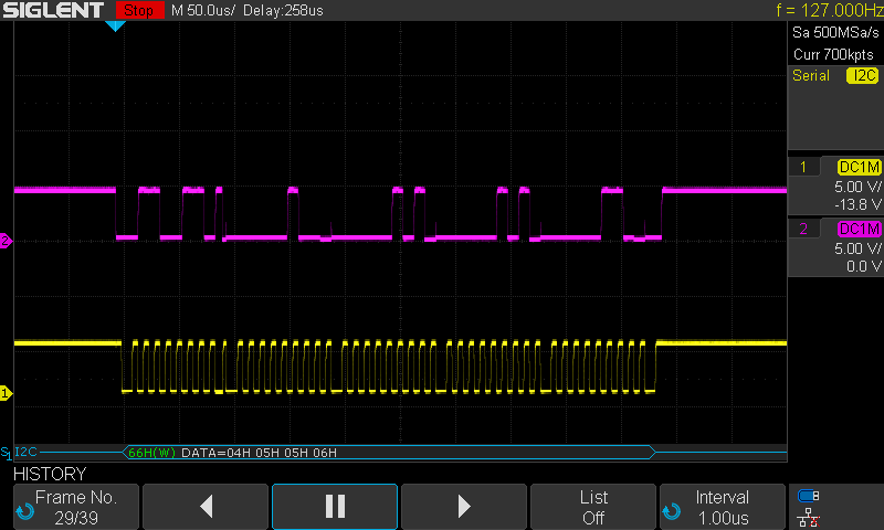

I am trying to communicate with a Nucleo_L476RG development board through I2C from an Arduino Uno. However I am having difficulty communicating more than one data frame. The first frame will accept the address and the data, afterwards it will not acknowledge the same address. I have used the I2C_TwoBoards_ComRestartIT example as a reference and have included the necessary 3.3 kohm pull up resistors in the transmission lines. The only real change that I have made is converting the example to 7-bit addressing mode and the master is an Arduino Uno.
First Frame of Data after Reset
Next Frame of Data
Code
