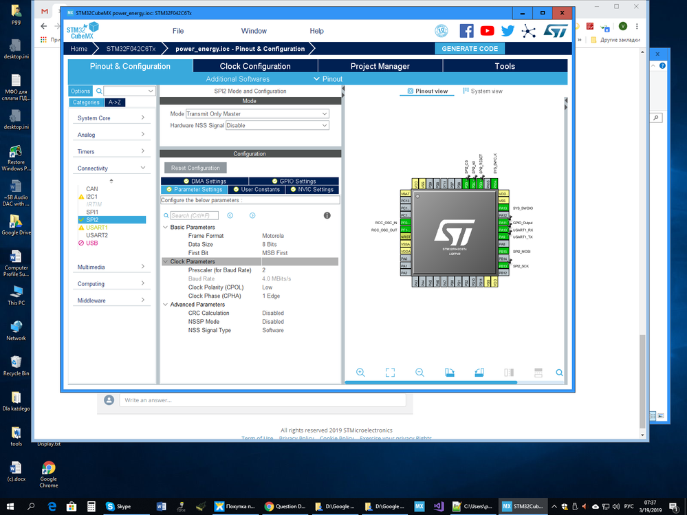

really I use master mode & 8 bit length.
2019-03-19 1:55 AM
I work with st7735 spi display.
I use program from github.
https://github.com/afiskon/stm32-st7735
this program work without any problem at STM32F103C8T6.
And after, I take this program & compile one for F042T6Tx microcontroller.
And program not work.
Hardware error!
I noticed that the program works to the point where the function transmits more than one byte.
Next, I replace code in hal_spi_transmit function.
take some code from f1 hal driver & put one to f0 hal driver.
And program work!!!!
but this is not good idea, I think, change standart ST library driver.
