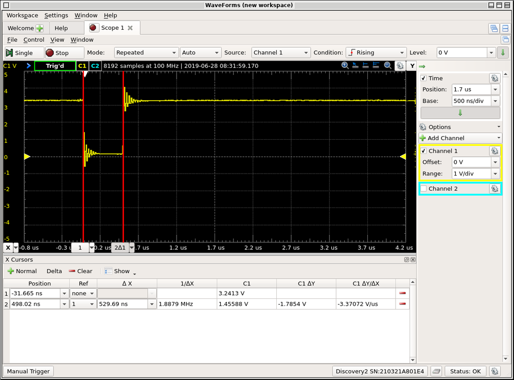

I thought that zeroing the SR should acknowledge the interrupt ans wait for the next timer invocation, but it doesn't. I've made screenshot from oscilloscope connected to the LED gpio.
As we can see there is very short transition from high level to low level for 529ns. It is too short for set period in PSC and ARR registers, because it should have about 120ms.

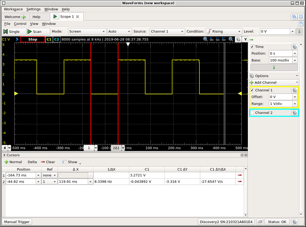

I've made also screenshot when there is 11th line added - and it looks like this:
As we can see now the period is about 119.91ms - and it is as should be.

This is a known effect. It takes time while the zeroing of interrupt flag propagates from the timer into the NVIC (interupt controller), and if upon exiting from ISR the processor/NVIC still sees the interrupt flag being high, the processor starts executing (tail-chaining) another ISR.
Place the status register clear as the very first line in the ISR.

Thank you for rapid answer. Your solution helped me.
