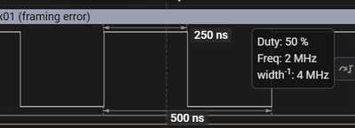

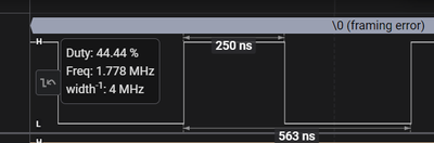

2024-11-07 7:34 AM - edited 2024-11-07 7:47 AM
So I probed PD1 pin, the fisrt capture show the uart BEFORE LTDC, the second one is after LTDC, it look the same, but the timings are off. Every HIGH-LOW transition are little bit slower. So the baudrate after LTDC is 12% slower. The original baudrate is 115200, if I set my analyser to 101375, the second became readible. So why the UART become 12% after LTDC was init ?
2024-11-07 7:22 PM
The same goes for SPI. I set the CLK to 2Mhz, this is what I get if LTDC is NOT init. Exactly 2Mhz.
Now when LTDC is init. 1.778Mhz, which is also a loss of about 12% like the Uart. It seems the LTDC slow down the whole clock domain...The same happen when I choose HSI or HSE.
