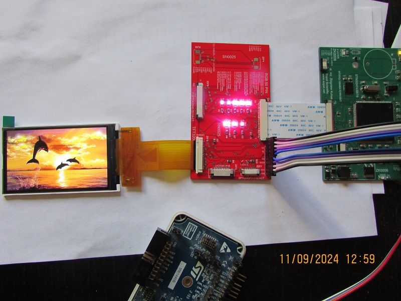

2024-11-09 9:54 AM - edited 2024-11-09 9:55 AM
This is how it looks now
