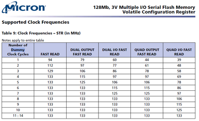

Here is my initialization code for OctoSPI1. I evaluated the number of dummy cycles from 1 to 15. It only works correctly with 10 dummy cycles. based on this, I estimate that we are operating at a clock frequency of 125MHz(Flash to read only under the condition that the dummy cycle is 10.). I am currently reading only 4 bytes.

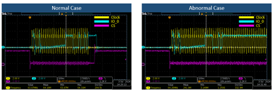

In the conditions where the issue occurs, the clock continuously generates without interruption, and the data line remains consistently high and CS line low.
