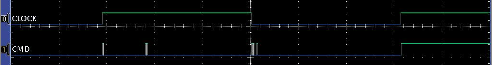

2020-12-04 5:51 AM
For information, I think I found the error.
The clock frequency at initialization is 400 Khz.
However, the frequency for the CMD line is 500 Mhz.
I think the frequency of the CMD line should also be 400 Khz.
But how to change this frequency for the CMD line?
2020-12-04 6:45 AM
Solution found, TranceiverPresent been on SDMMC_TRANSCEIVER_NOT_PRESENT
Set now at SDMMC_TRANSCEIVER_PRESENT
