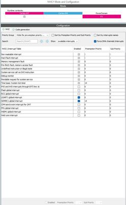

SDMMC1 Interrupt: Enabled, priority set in NVIC to 14

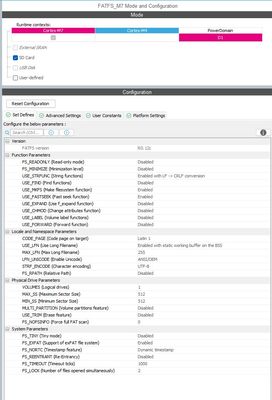

FATFS enabled under FATFS_M7
Filesystem: exFAT
LFN Mode: Static allocation, work buffer in .bss
Enabled DMA Template

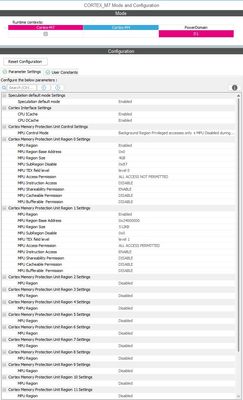

MPU Region 1 (AXI SRAM Region):
Base Address: 0x24000000
Access: Full access
TEX: Level 1
Shareable: Disabled
Cacheable: Disabled
Bufferable: Disabled
(MPU Region 0 is default)

Just to see, cache is a problem: switch off D cache or not enable it.
And try setting higher priority for sdmmc, I use 3 , try.

FATFS might need to accommodation for CODEPAGEs and legal characters you can put in short file names, and perhaps the Unicode in long file names. Check LFN is enabled.

Hi @Tesla DeLorean , thank you for your response. LFN is enabled, and I've also enabled exFAT. To clarify the issue: I'm writing an English string for instance,
