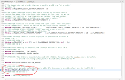

2025-05-15 7:47 AM
You should define INCLUDE_eTaskGetState in project file FreeRTOSConfig.h

Thanks for your reply, I used CMSIS RTOS v1 as i am following along some FreeRTOS tutorials which also use the same v1.

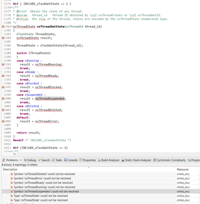

I defined the macro in FreeRTOSConfig.h like this:
But, i get a bunch of errors related to the osThreadGetState function:
Any suggestions ?

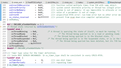

2025-05-16 6:28 AM
In cmsis_os.h, I still see INCLUDE_eTaskGetState "grayed out", even though i have it defined in FreeRTOSConfig.h :( , I am not sure why!
