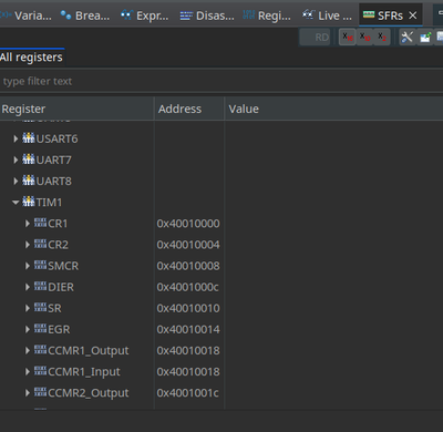

to check, the tim/pwm setting: just stop it in debug and look at sfr -> tim1 , to see, whats it doing:

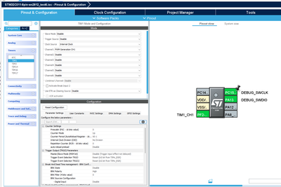

htim1.Instance = TIM1;
htim1.Init.Prescaler = 0;
htim1.Init.CounterMode = TIM_COUNTERMODE_UP;
htim1.Init.Period = 60-1;
htim1.Init.ClockDivision = TIM_CLOCKDIVISION_DIV1;
htim1.Init.RepetitionCounter = 0;
htim1.Init.AutoReloadPreload = TIM_AUTORELOAD_PRELOAD_DISABLE;

Are the pins properly configured?

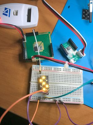

This is my basic setup, I just swap the 2 break out boards, same leds , using a bench powersupply at 3.3 volts ,
I preformed all my original testing with the G030, with the C011 , I have only run basic led toggling code. before trying to move my code from G030 to it.
All done with the CubeIDE, just configured a new project for the C011
, Then used the IDE's compare file feature to code over my parts of the code from the G030 main.c, not using any libraries or extra .h .c files.....
