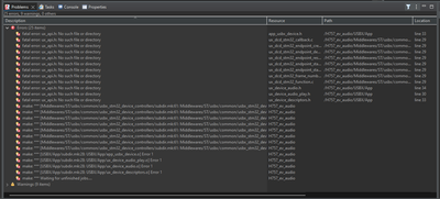

Sorry, I missed this response. Okay we can proceed with your plan. However, the project you provided still gave me errors which I'm sure are due to file location issue.
As for the other solution, I will test tomorrow, unfortunately I don't have the product with me to test. To be updated in a new question!
As soon as this compiles, I will mark it solved. Sorry I haven't been able to compile it to test it.
Hello @FBL - I haven't heard back about this part yet. I wasn't able to compile the project you shared yet.
