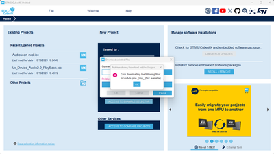

  2. To create a new project, I press "Access to Example Selector" (side note, I get a popup with "Problem during download..." see image below, which I'll press okay and then it'll say "Download has failed, some data may not be updated". )
