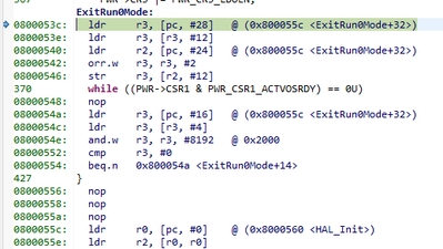

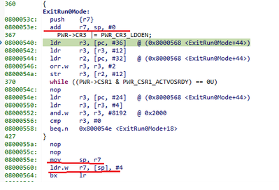

2025-11-28 5:39 AM - edited 2025-11-28 5:45 AM
Hi @KnarfB ,
I may found a solution to that unwanted access to the stack by replacing:
void ExitRun0Mode(void)
by
void __attribute__((naked)) ExitRun0Mode(void)
But this is applicable only for GCC.
With the "naked" attribute: no SP is called:
without "naked" attribute: SP is called:
Could you test from your side?
