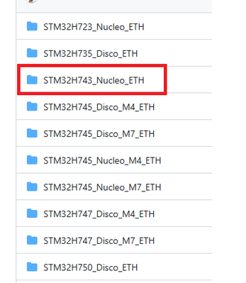

2025-06-12 4:03 AM - edited 2025-06-12 4:07 AM
@Ematic wrote:
We have checked on your all procedure to enable the Ethernet in the STM32H753ZIT6 NUCLEO-H753ZI (Development Board) with your reference, but the model and type is different(as per your reference).
If you mean by that you are using NUCLEO-H753ZI while that board is not available in the github.
You can use NUCLEO-H743ZI

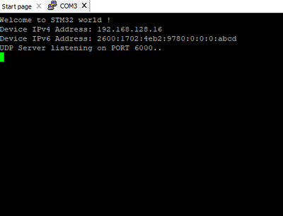

2025-06-12 6:30 AM
Hi @mƎALLEm
We have verified your example project (STM32H743_Nucleo_ETH) for connecting Ethernet to the NUCLEO-H753ZI development board.
But still its not working, we have attached our working files . Seeking your support in this matter.
