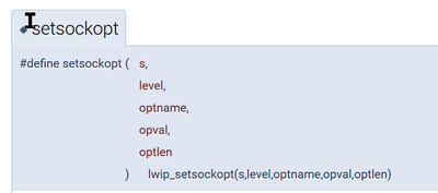

To be quite frank I find the ST Ethernet firmware and builds to be a nightmare. You basically have to be an experienced network engineer first to understand the jargon. SMTP, DHCP etc which is never spelled out in full in the cube help panel and secondly to work your way through the code which is like spaghetti to find out what is going wrong. LwIP is very clever, but its documentation is a joke considering how widely it is used. Compared to a system like FreeRTOS which has excellent documentation, a vibrant forum and heap and heaps (pardon the pun) of examples, LwIP is more like a hackers bad dream. Its been around for over twenty years yet the documentation is sparse to say the least.
The Wiki content for the socket API is just a regurgitation of the header file for the macro or function. Here is the entry for setsocketopt:
Now I'm guessing that setsockopt sets some options for the socket the application programmer is trying to instantiate. But it doesn't explain that, or what the various macro parameters do and what valid inputs they can be.
I am guessing that s is the socket handle, but what the rest of them are is beyond me. An application Programming Interface needs a lot more than code it needs an explanation of what the function does, when you should use it and what its parameters are.

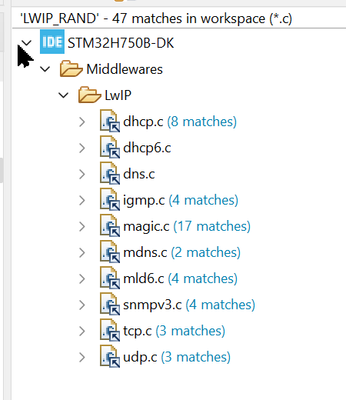

I did a search for LWIP_RAND and found it is sprinkelrd liberally around the LWIP code:

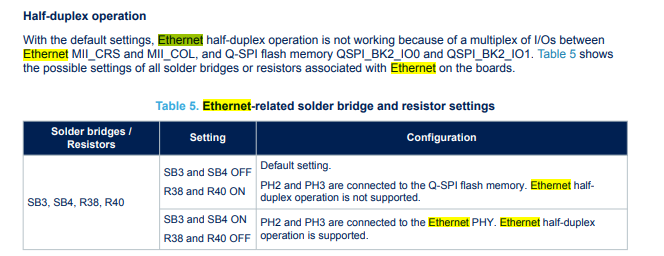

I have configured for 100Mb full duplex and have checked this. I also checked the solder bridges and resistors and they are in the default configuration. I am using the same config as Adams i.e. MII not RMII.
I will check the pinout and config again just to be certain and will get back to you. Like you I don't understand why rand() works in main, but not in a task.

12. GPIO examination. I checked the GPIO's assigned for the ether net peripheral against Adams working version and I found a difference. viz.

I would would like to try the system with no TouchGFX, just using FreeRTOS and LWIP. The problem I have is that I need the external flash and bootloader provided by the TouchGFX build to fit LwIP in and I haven't a clue how to do that and I don't have the time to learn as I need to get on with my current project. I have spent about 24 hours work time on this.
I will try the rand() function on a project generated by CubeMX and see if it is different from that produced by TouchGFX.
