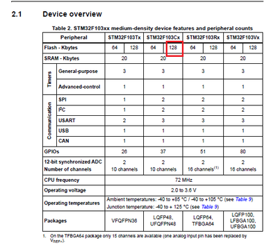

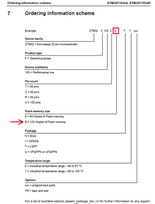

Hex file does not reflect the real size of the application. It contains also the addresses: https://en.wikipedia.org/wiki/Intel_HEX
If your the generated binary exceeds the Flash size oh the MCU you beed to migrate to a bigger flash size device:
