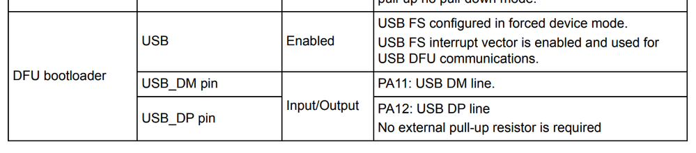

Looks like the USB connector on that board is using the HS USB which is not supported by the STM32 bootloader.

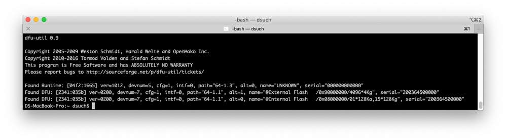

I tried dfu-util as well. In the Arduino bootloader I can see two DFU mode devices listed for the Portenta (internal and external flash). When I jump to system memory using the address in the ST suggested code the mbed OS crashes (indicated by the RGB LED flashing a red SOS).

Thanks TDK - you were on the right track. The Portenta can do both HS and FS USB however Arduino devices have a proprietary USB VID/PID. This was the problem. All we needed to do was modify the BetaFlight Configurator source to recognise the VID and PID. I appreciate your assistance and the time spent looking into our problem.
