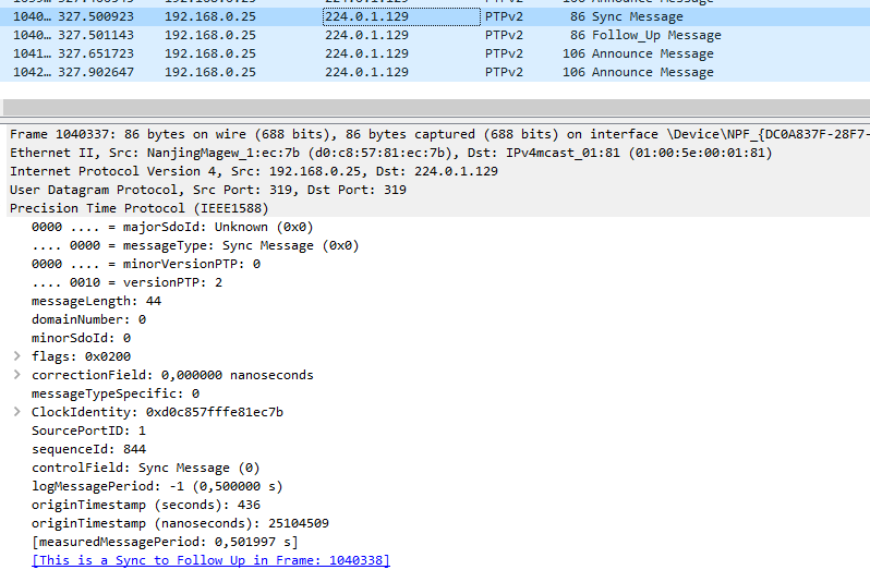

See here a screen capture from WireShark. For me it looks like PTP over ethernet.

No.
Problem found, check the Wireshark message: it is UDP.
Check if you can change the master to pure PTP over ethernet (Ethernet Type of an Ethernet-encapsulated PTP message is 0x88F7).
2025-06-25 5:30 AM - edited 2025-06-25 5:30 AM
Yes, those packets look like PTP over UDP.
