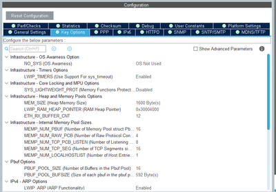

4. Enable LWIP and set static IP
Set PHY driver
Heap options are default

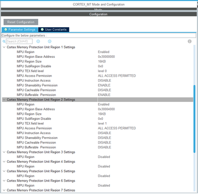

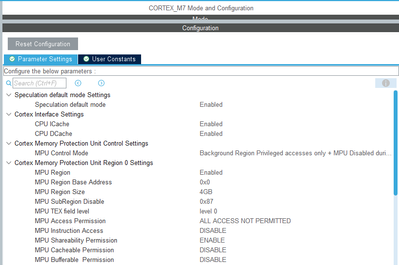

5. Enable cache and configire MPU.
6. Add DMA sections to LD scripts, both FLASH and RAM

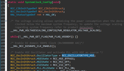

@ASEHST, looks like I found the root cause of this problem.
LwIP_UDP_Echo_Server example contains __HAL_RCC_D2SRAM1_CLK_ENABLE(); in it`s SystemClock_Config(void) function.
But projects that are generated by CubeMX lacks this call. And when board is cold-booted, like @AGP_29 mentioned, __HAL_RCC_ETH1MAC_CLK_ENABLE(); in void HAL_ETH_MspInit(ETH_HandleTypeDef *heth) of ethernetif.c, thashes out D2 SRAM where LWIP heap is located.
I manualy added this call to my project in the same place and looks like problem has gone.

Yesterday i downloaded STEA`s project, changed IP to match my test subnet and it worked. I compared settings to my project and the most significant difference was MPU config. I changed MPU config in STEA`s project to match my, and it still worked. I havent found any other differences, so i left further investigation for next day.

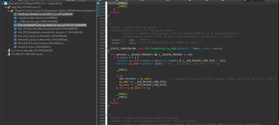

Today i launched STEA`s project with my last changes, and got no pings. I throught that i accidently broke something. But when i repeated exactly same steps that yesterday gave me good result - ive got non-working project. I supposed that my board died. I launched LwIP_UDP_Echo_Server example, and it worked. Right after it, i launched newly imported STEA`s project and it worked 0_o. I poked around, and after few resets and launches, STEA`s project stopped working again. And i got hardfault.

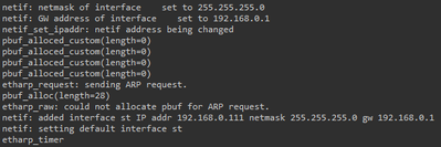

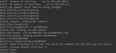

I used to enable LWIP debug and saw that it fails to alloc pbuf when tries to send ARP.
Just for test i enabled MEM_LIBC_MALLOC in LWIP->Key Options
And allocation error had gone. But I still cant ping it.
