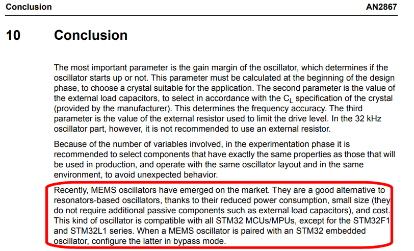

@Tesla DeLorean wrote:figure out how to redesign the board with the right crystal and components to oscilate within a short/defined period.
@Sany After carefully studying the AN2867 already mentioned by @mƎALLEm
Also AN4938, Getting started with STM32H74xI/G and STM32H75xI/G MCU hardware development:
You might also consider whether you'd be better off just using an oscillator ...
