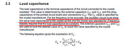

I don't think CL could induce the described issue at the beginning.
The CL are responsible to fine tune the frequency of the crystal:
From AN2867 "Guidelines for oscillator design on STM8AF/AL/S and STM32 MCUs/MPUs":

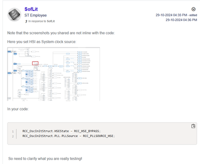

And you still didn't answer my question regarding what the exact config you are really using?
Please answer the question from my previous comment:
Bypass or not? you should not use Bypass in your case as you are using a Crystal.

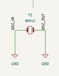

2024-10-30 2:51 AM
2024-10-30 2:56 AM
@Sany wrote:i check my schematic, and i found a big problem, i have a crystal with 8mhz on 2 pins, but i forgot the decoupling condensators on the side to ground... :(
It's worse than that!
Both sides of the crystal are shorted to ground!
@Sany wrote:i think, that was the problem..?
Yep - which shows why it's important to post the schematic!

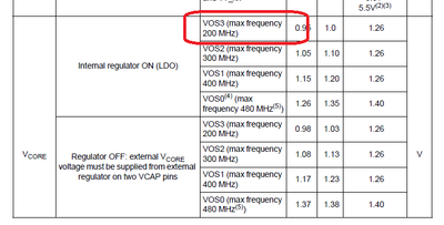

2024-10-30 3:02 AM - edited 2024-10-30 3:05 AM
Just a question: your system clock is set to 75MHz, and the VOS is set to VOS2 while it needs to be set to VOS3:
Did you set it manually or it was set automatically by CubeMx?

CubeMX sets automatically the VOS2, i changed the VOS2 now to VOS3 manually.
i created a new project, and CubeMX sets VOS to VOS0 and Product Revision to "Y". When i change the Product Revision to "V" then sets CubeMX VOS2.
That's a good hint, i wouldn't have noticed it, because my code runs, after disabling the HSE.
here is my corrected config, with VOS3, 160mhz, and disabled HSE.
