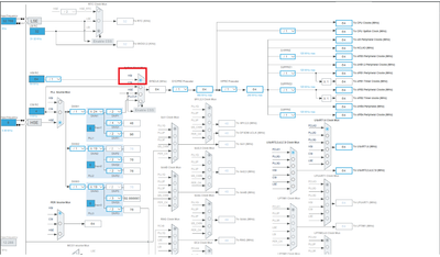

Hey Guys,
I have problems about configure my STM32H743VIT SysClock.
On my own PCB, i have a Crystal with 8 MHZ, and a LSE of 32.768 khz.
Settings are in my Screenshots, now if i debug my application, it ends in a Error Handler.. but why?
BTW: UART4,5,7 and USART1,2 enabled, and USB_DEVICE + USB_HOST is enabled.

2024-10-30 8:48 AM - edited 2024-11-07 5:19 AM
Hello @Sany ,
your attached ioc file is setting the system clock to 64Mhz with HSI.
I'm very confused. We need to converge.
So to conclude: if you have
Rev Y: Max system clock is 400MHz at VOS1.
Rev V: Max system clock is 480MHz at VOS0.
I'm attaching your ioc file with some modifications I did to set the crystal at 8MHz and system clock at 400MHz at VOS1 (this is working on rev Y and Rev V) / with:

2024-10-29 9:35 AM - edited 2024-10-29 9:36 AM
Note that the screenshots you shared are not inline with the code:
Here you set HSI as System clock source:
In your code:
RCC_OscInitStruct.HSEState = RCC_HSE_BYPASS;
So need to clarify what you are really testing!

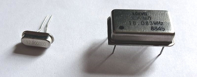

2024-10-29 9:40 AM - edited 2024-10-29 9:42 AM
@Sany wrote:
Sorry, I have a XO with 8 MHZ and 2 Pins,
Need to check again if you are using a crystal or crystal oscillator:
At the left is a Crystal and at the right it's a crystal oscillator. The latter needs to be powered.
Could you please share your schematics?
2024-10-29 9:49 AM
@Sany wrote:Sorry, I have a XO with 8 MHZ and 2 Pins,
Nope: with only 2 pins, it can't be an XO (Crystal Oscillator).
A crystal oscillator is an active circuit - it requires power - so will need at least 3 pins (supply, ground, output).
Difference between just a crystal, and a crystal oscillator:

If you are using TWO pins OSC_IN/OSC_OUT you are using a CRYSTAL
For an XO you'd need ONE pin OSC_IN (4-25 MHz) and BYPASS mode, ie the STM32 is NOT simulating the crystal
RCC_OscInitStruct.HSEState = RCC_HSE_BYPASS; // Clock on OSC_IN, and OSC_OUT NOT VIABLE
