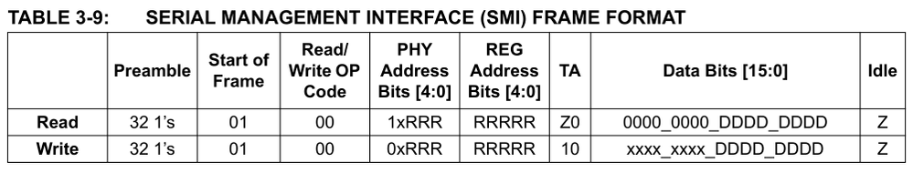

I am trying to use the KSZ8863 IC and (as shown in Table 3-9 of its datasheet) it has many configuration options behind a tweaked version of the standard MIIM interface. In particular, the opcode needs to be set to 00.

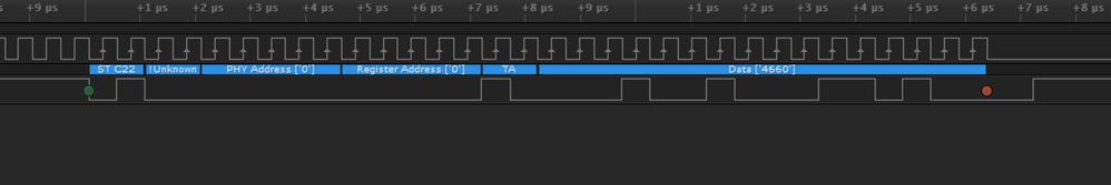

For any future users who stumble across this: I got a logic analyzer and it turns out that even though it is not "allowed" in the RM, it is possible to use the SMA peripheral to execute the custom "write" instruction:
To do this:
This results in the following transmission on the wire: note that OP=00 despite it being listed as "reserved" in the RM, with the desired ST=01. I am just sending (bogus) data 0x1234 to register 0 as an example. EDIT: I have also verified that the write is accepted by the device.

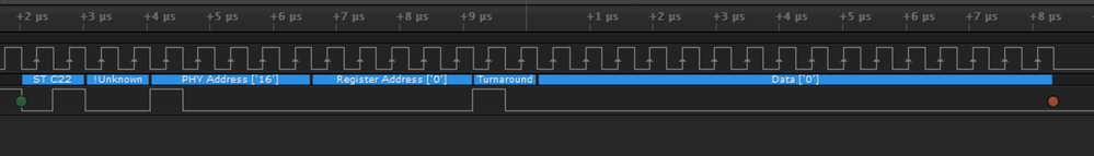

The bad news is that the custom read instruction does not work. Here is an example where I have done everything as in the write, but also cleared DR, and asserted the high bit of PA:
You can see that the everything till the turnaround is correct, but the data is 0. I assume this is because the STM32 is driving the MDIO line since it does not know that this is a read command, and the device (KSZ8863) cannot drive it.
I cannot find any other (documented) bits in ETH_MACMDIOAR that could possibly affect this behaviors so at this point I am being forced to give up on this and assume bit-banging is the only way this peripheral could be used for this protocol. For ST engineers: it would be great if there could be just a tiny bit more flexibility in this peripheral (perhaps one of the reserved bits of ETH_MACMDIOAR could be used to explicitly signal if the data line should be driven or Hi-Z).

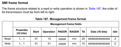

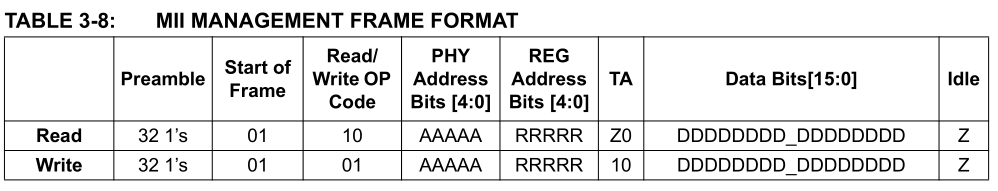

Except for the op code (which seems to suggest using the clause 45 bit), I notice that the protocol calls for "01" for the "start of frame" as shown in these tables (first regular MIIM, then the modified SMI)
To do this:

As mentioned by OP ( @avik.de ), I similarly do not see a way to set the dataline to HiZ.EDIT: from the Reference Manual, it seems the default for the SMI frame format is HI Z in the turnaround:
It seems plausible that the 10 in the operation being overwritten with 00 inhibits this HI Z default for the read operation.
