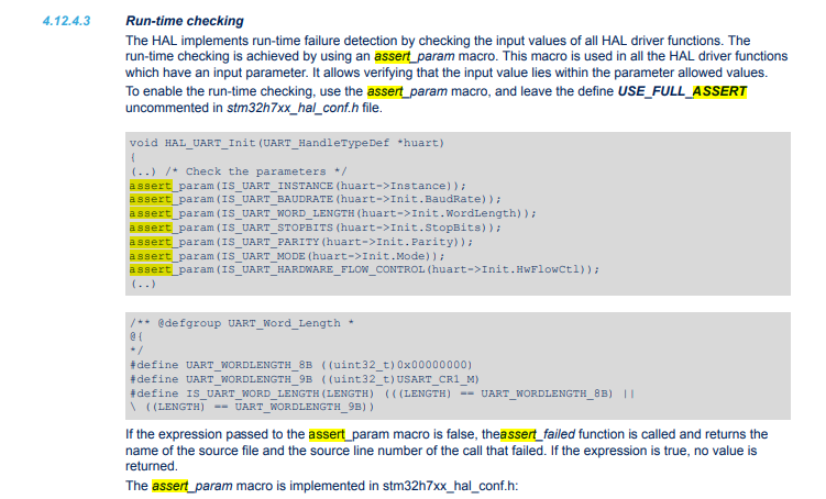

Please activate the flag USE_FULL_ASSERT to be able to check the input for peripheral configuration.

2025-02-13 6:33 AM
Hello @Danish1
Please refer to user manual UM2217 for better use of the HAL drive.
The full assert functionality detects invalid input values. Therefore, if you don't use input values from the HAL driver, it is important to activate the USE_FULL_ASSERT flag.
