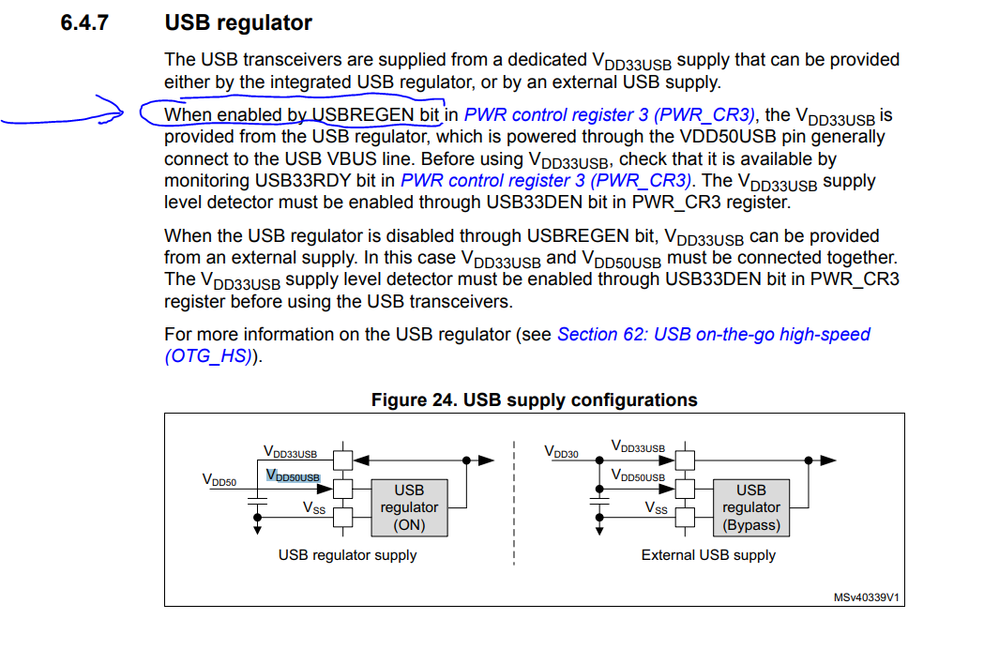

2023-02-25 1:43 AM
Hmm,
i found out this in the reference manual .
Searched for USBREGEN inside the hal library, and came across this function HAL_StatusTypeDef HAL_PWREx_EnableUSBReg (void)
I implemented it after in the MX_USB_DEVICE_Init function.
Now it seems to work, i get Virtual com port 9 in windows !!!

2023-02-24 11:01 PM
Hi Jan,
thanks for the hints... I am stil strugling with these.
I am really wonder if VDD33USB pin needs to be connected somewhere.
I connected only VDD50USB to the +5V line from the usb connector
2023-02-25 1:43 AM
Hmm,
