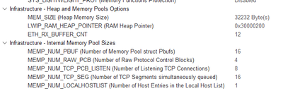

My ethernet configuration:
My LWIP configuration:
Any leads or comments would be greatly appreciated, as I'm new to the stm32 and to memory management of microcontrollers.
