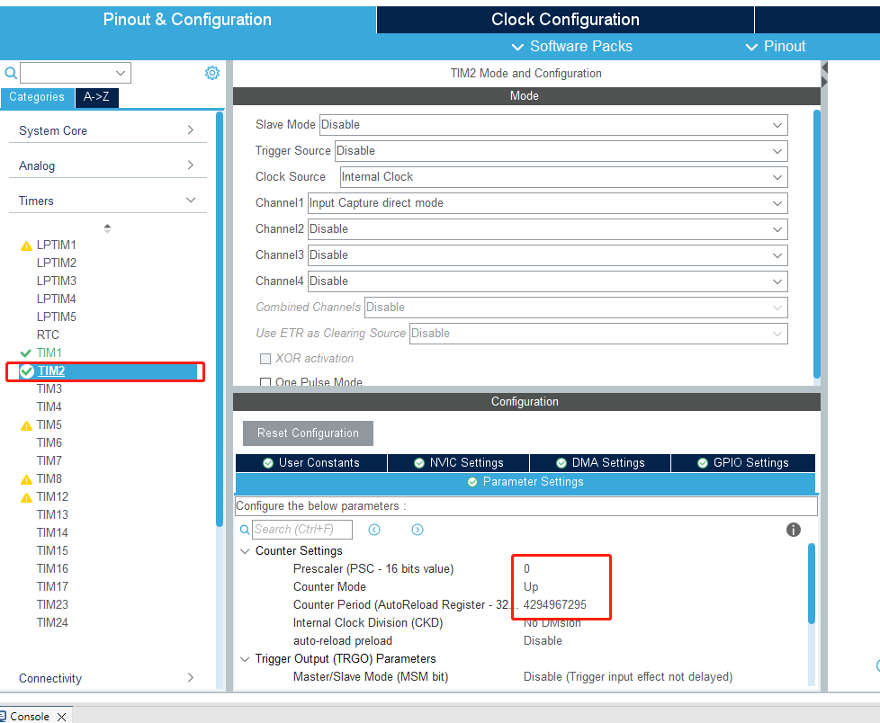

Currently using NUCLEO-STM32H723ZG board.
I'm setting TIMER1 as a PWM output, TIMER2 set as Input Capture direct mode
try to measrue the frequency output from TIMER1.

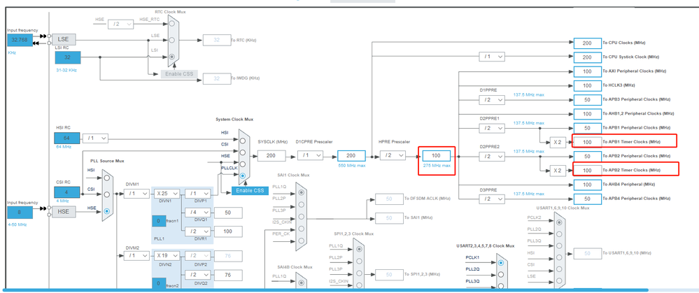

Clock Configuration : APB1/ APB2 Timer Clocks 100 (MHZ)
Timer 1 :
Timer 2 :
Whenever I modify the TIMER1 output PWM over 200KHZ, I can't get the stable value or even zero from the HAL_TIM_ReadCapturedValue.

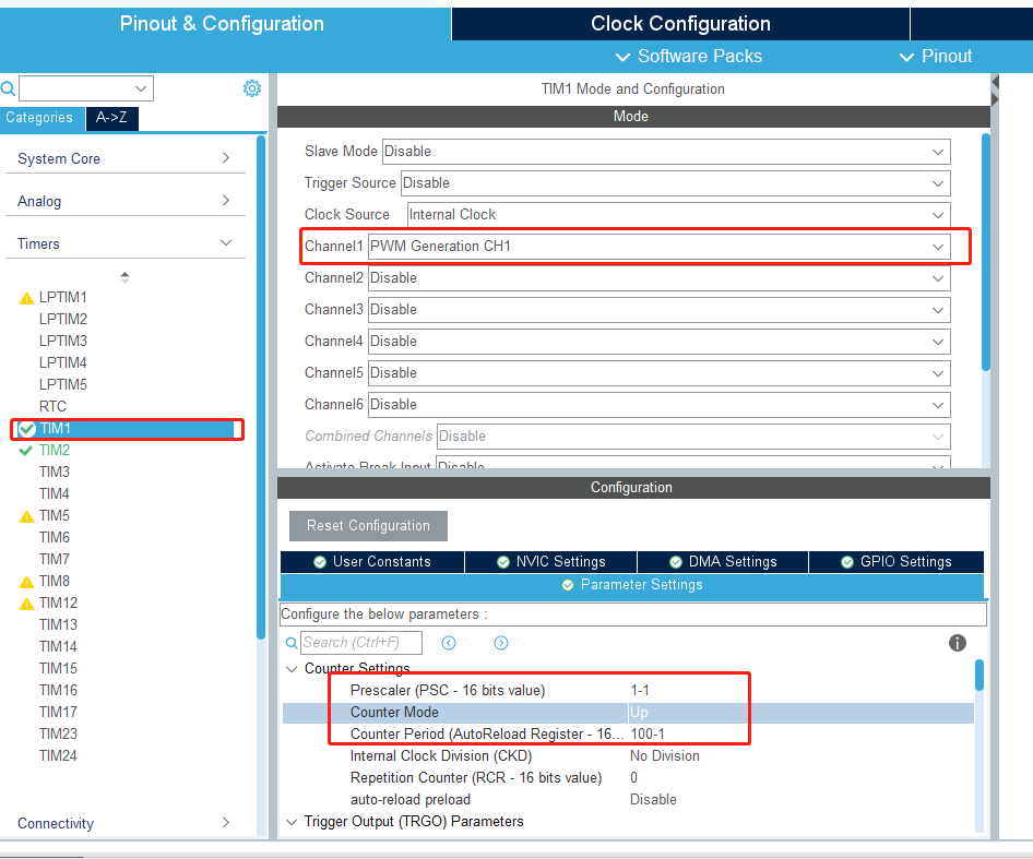

I set the TIMER1
But I got read back like this.

TIM1 : Internal Clock, PWM Generation CH1, PSC 275-1, Counter Period 100-1. ( Which will generate 10KHZ PWM output)

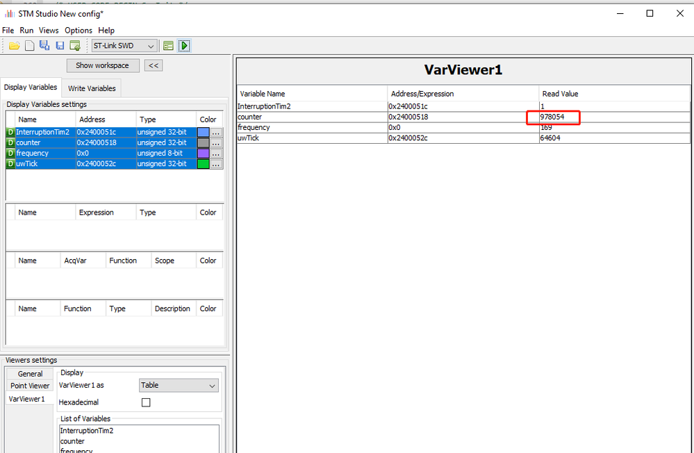

However, every time I add the interrupt function for TIM5, it causes an error in my output. The value of __HAL_TIM_GET_COUNTER(&htim2) should always be less than 65535, as I have set it, but it always exceeds this limit. As you can see from the counter value below, it is over 65535.
I am not sure which part of my settings is incorrect.
