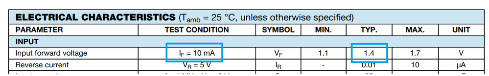

My standpoint: it is recommended to use an optocoupler to protect STM32 microcontroller from high-voltage spikes and ground loops in your case and you need to use a high-speed optocoupler. Example 6N137. (I think it can handle up to 5MHz as input. You need to contact its manufacturer Vishay).
You need to limit the current on the LED side from 24V. Example: if you use 6N137 as an optocoupler, to limit the current on the LED, you need to add a resistor in series Where R = (Vencoder - VF LED) / IF LED .
R = 2,260K. Standard value: 2.2K.
Hope I've answered your question.
