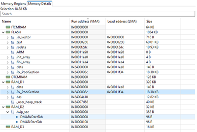

0) please use the </> button when posting any source code, also for linker files. The posts are unreadable / ugly enough to keep from looking at it... :D
1) For complex stuff: RTFM! CubeMX should not be trusted 100%.
Check the H7 datasheet and reference manual, there you find that SRAM1 & SRAM2 in D2 domain have only 16 kB each.
2) Also make sure that the lwIP memory is not put into DTCM RAM, because that cannot be accessed by the ETH DMA.
3) Not sure that LWIP_RAM_HEAP_POINTER must be in SRAM2. This is actually only a re-definition of the "ram_heap", which is declared in arch.h at #define LWIP_DECLARE_MEMORY_ALIGNED_HEAP.
I put the lwIP heap in AXI RAM by adding the attribute to that line:

So, after all my hints and complaining, your memory location should be okay, because DTCM is unused (what a waste! I like to put the stack there), and a little of RAM_D2 is used, probably for the ETH descriptors.
So this was an almost useless post... sorry! :D
2026-01-21 2:44 AM - edited 2026-01-21 2:46 AM
Your memory configuration should closely match the one shown above—please verify it against your setup.
Also ensure that the PC network and STM32 network are on the same subnet.
Do not add any user-defined macros in lwipopts.h; let CubeMX handle the configuration.
If you still cannot ping the STM32, uncomment #define DATA_IN_D2_SRAM in system_stm32h7xx.c and test again.

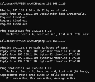

Hello @Srivatsan,
That example should work immediately without any modifications if both devices are on the same network. I suggest installing Wireshark on your computer to monitor network traffic and see exactly what happens when you plug in the board. Check if the board sends an ARP announcement. Also, try testing on another computer, as Windows might be blocking your pings.
Best regards,
