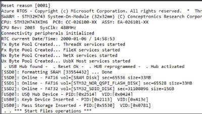

Ok, I finished re-writing the Host Only and Device Only drivers, and it seems to be working properly now. The H7 works with a hub and multiple devices on the host side. I still have to test the Device side next week, but hopefully that will be a bit easier.

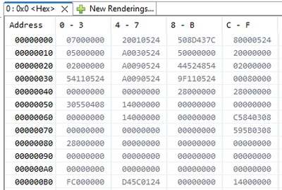

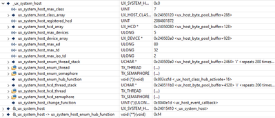

One of the problems is the main structure (pointer) _ux_system_host is not initialized. The address for _ux_system_host is 0x00000, so it is storing the values of the structure in the ITCMRAM section and it is not using the pool like all the other variables. I don't know if this is where you intended to keep the structure, but I had to turn off the icache so it didnt over run the structure.
Also, the _ux_system_host_enum_hub_function is not set properly... it should be ux_host_class_hub_activate, but for some reason there is a +16 added to the function, so when it tries to jump to the hub function, it gives an address error.

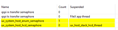

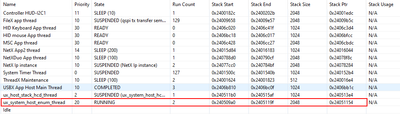

semaphores seem to be setup properly:
memory pools look ok. They are where I expect them to be,
