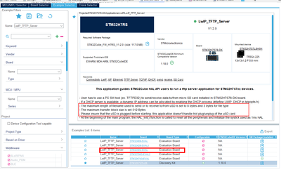

I am using Nucleo-H723ZG which is not listed under the module which has LwIP_TFTP_Server. The module I am using only has four example codes related to LwIP and none includes TFTP.

I used that for reference regarding ethernet and mpu configuration. In that example code SD card is used to store the file, whereas I am directly writing the file in the user flash memory which I will be receiving from the Ethernet.

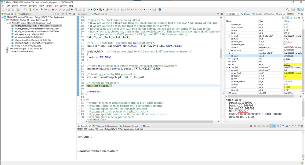

My concern lies here. While debugging we can see that the local port, destination port, addr is correct and after executing the udp_sendto line I got err = 0 indicating that the acknowledgement so successfully sent. But it can be seen in wireshark nor the client proceeds to send the data packets.
