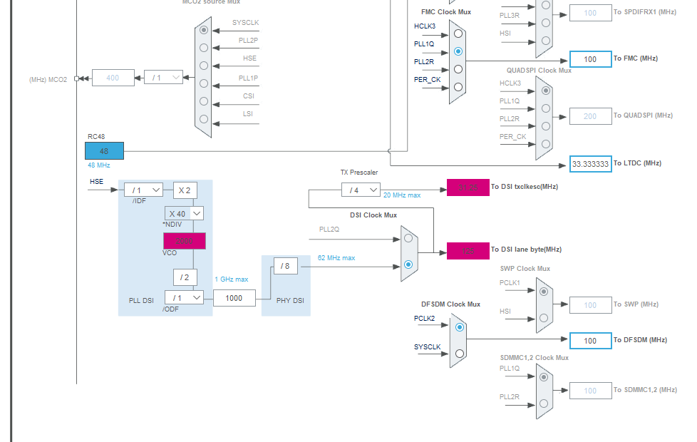

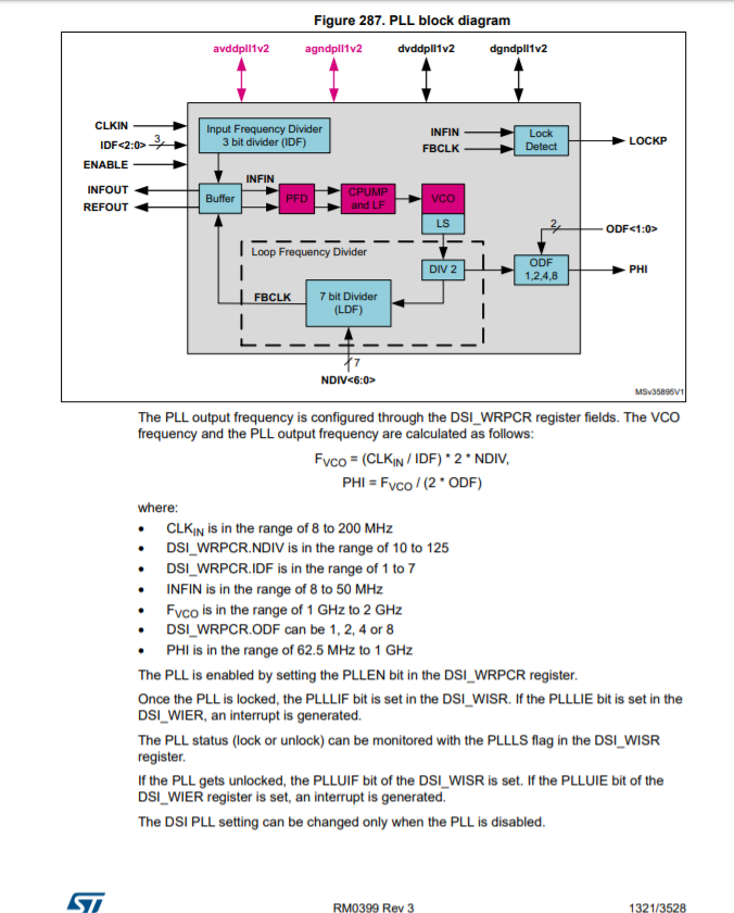

There is inconsistency in the reference manual and the STM32CubeMX clock configuration tool as to what the maximum clock for the PLL DSI. Reference manual suggests it is 1000 MHz however, when set to that in STM32CubeMX, an error is generated at the PHY DSI lane byte frequency with a maximum of 62MHz instead of an expected 125MHz

Yes its DDR on the output clock at but according to the RM the PLL puts out 1GHz. When using those setting CubeMX gives an error so I'm not sure if there is a hardware limitation or just software bug in CubeMX. Don't have hardware yet so can't test at the moment.

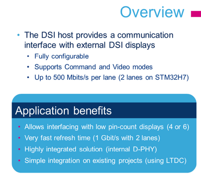

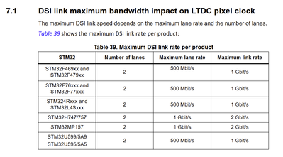

For STM32H7 it is 1Gbps per lane - 2Gbps total.

Ahh, yeah, I mean dual core STM32H7 MCUs:
From STM32H747 datasheet:
From AN4860:

Four years on and the confusion is still here. It's unclear whether this is a bug in CubeMX or a hardware limitation.

EXACTLY - STILL this issue is available - shame on ST !!
