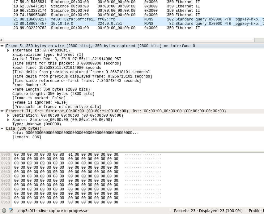

Unfortunately the packets I receive are just raw Ethernet frames w/ no recognizable protocol. I searched around and only found one other post about this and the fix for them was to call LwIP_Process() in the main loop which I am already doing.
Here is what wire-shark is capturing on the interface the stm32 is connected to:

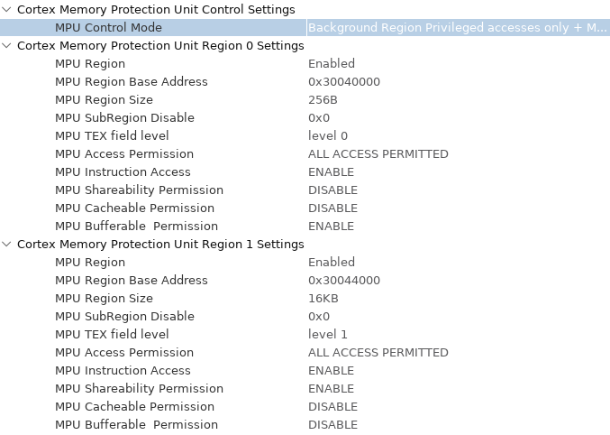

Here is my MPU Configuration:

2019-12-03 10:42 AM
And what address is it *actually* using for the buffers, not just the descriptors.
Perhaps make the memory area larger, and make sure you commit any data with a fencing instruction, or explicit flush. ie __DSB, and SCB_CleanDCache_by_Addr()
2019-12-03 10:42 AM
2019-12-03 12:16 PM
Oh this was it, the Txbuffer in low_level_output was on the stack and was being cached. Adding SCB_CleanInvalidDCache() before calling HAL_ETH_Transmit(....) in ethernetif.c fixed the issue for me.
